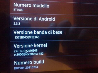

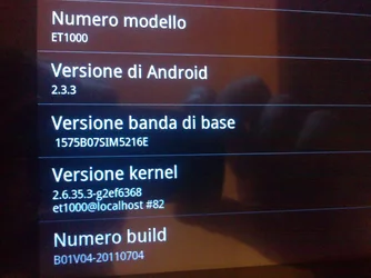

Hi guys
I upgraded my drembook w7 to v25 hd105 as your instructions (you can see from the photo), I can say that it seems to work more stable 3g,
gps ok, wifi ok bt ok, but I ask: why DreamBook written has disappeared and now appears ET1000? $06082011001.JPG
Hi guys
