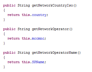

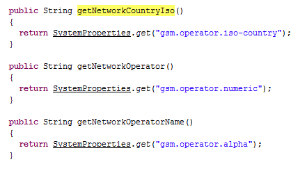

Well, I found where the China Telecom was coming from. This is from the framework.jar file.

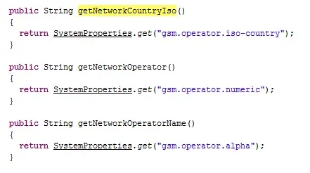

This is from my phone framework.jar
This makes sense why no matter what properties I set, it always returns the same thing. At this point, I think I'm almost over my head. Changing their default values to something US based and recompiling the file would be great, but beyond me. :) Anyone have any experience with this? Not sure if this would even fix it, but it could be worth a try.
