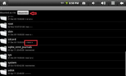

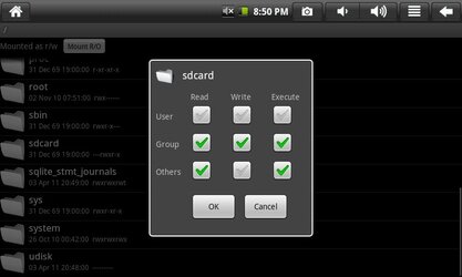

Hi cfrockit,
Looks like I'm very close, I got Universal Androot and Root Explorer working and I get to the permissions portion of the /SD card and it has three lines labeled USER, GROUP, and OTHERS. The Column Headersare READ, WRITE and EXECUTE. The USER line has none of the boxes checked. The Group line has all three boxes checked, and the Others line has Read and Execute checked. There are also an OK and CANCEL button. I have clicked all 3 boxes in the USER line and also the WRITE box in the Others line then clicked the OK button.
The SD Card still continues to be identified as Read Only R/O. When I go back into Permissions, the buttons I had earlier clicked are again unclicked. Any additional insight?
It seems so close to resolution but.............
Thanks
Beaw

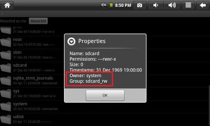

Here are a few screen shots, sometimes a picture provides more information. Also, check the Properties since the Owner and Group my be keeping files written to the sdcard.

Thank you cfrockit, the first two screen shots match what I see but I cannot get to properties. I have decided that I am satisfied with simply loading stuff on the mini SD card from my home PC and transferring to the tablet. It certainly worked fine installing Root Explorer and Universal Androot. Still a great device for 99 bux and still very satisified with its performance. After all, 90% of my use is related to surfing the internet so the other 10% can come in through the card.
