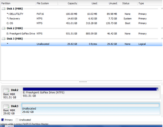

$SDcard - EASEUS PM.pngHere is what I get in my EASUS PM. I had used this program once before(on one of my many trials). What should I try to do with it? I still have the acclaim_update zip file on it. Should I partition it, or rebuild it? When I went to partion, it said: unallocated space before = 7.8MB; partion size = 30527.2MB; unallocated space after = MB.
Something strange there. See how it says file system "Unallocated" and "Logical" for type? It shouldn't say that. You want it to be "Primary" and should try to format it to "FAT32". Try the format option in the partition manager and see if it gives you these as options for the type of format you want.
