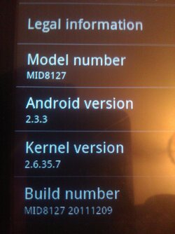

Ok, but if you check "Settings > About" you should have more details to know to which kyros model your tablet is similar.
This is my tablet details.
