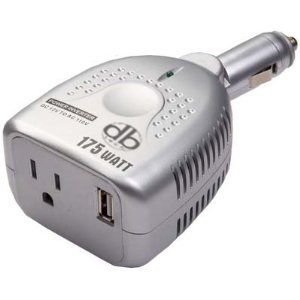

Here is a lighter charger that goes into your power plug, also includes a 6 ft extention cable.
http://cgi.ebay.com/Car-Adapter-Cha...=120722492223&ps=63&clkid=1722251026794139674
I use one like this for my AC charging needs in the vehicles.
This one is from Amazon.com, but you can get them almost anywhere. I was an OTA truck driver for a few years, these work great for small electronics. Powers my laptop without issue.

Problem with that is that you have high voltages hanging around in the car.
Not my preference.
Peter
I don't see it as a problem. I have a 300W inverter where I have a 4 plug powerboard where I plug in various chargers that I need.
Battery charger for my Cordless screwdriver
charger for my workphone
charger for my bluetooth phone head set
In fact I have a 4 plug adapter on the cigarette lighter slot into which I plug:
My GPS
The 300W inverter
My personal phone's car charger
and into the USB plug on that adapter I plug in all my USB devices that need charging.
The inverter should have a grounding terminal - in addition to Red and Black terminals. You are very safe because the inverter is design to shut down in the event that there is a short/earth leakage. If you got a good one that is.
Why not? The car's PCM and all other computer modules are running off the same power source. They are equally as sensititve.
The difference is that car electronics are designed to deal with a 9-15V nominal range with spikes up to about 400 Volts of either polarity.
I won't be plugging my pad directly into vehicle power, EVER, without a properly designed buffer circuit.
I've designed battery chargers that are literally Taser-Proof, but I'm going to bet that the one in the pad is pretty minimal, designed for a reasonably regulated SMPS wall wart as supplied.
There are safe converters that will protect your pad from the transients, and of course going through an inverter is an effective if bulky and inefficient solution.

The reason I prefer an nverter rather than plugging directly into the car 12v supply is because there is a way of isolating the ccts, as well as earth leakage protection. Inefficent it may be but it is safe.
