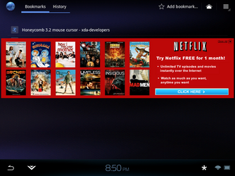

Oddly enough, I have a screen capture of "Titanium Backup" not working in another reply to you at: http://www.androidtablets.net/forum/vizio-tablets/37996-costco-gingerbread-vtabs-3.html#post205286 so I will leave it there and mention another problem I found with the HC VTABs. But first a screen capture of the problem:
What you see above is from the Android Browser and it is part of the screen from www.youtube.com being displayed on top of the History. All you have to do is tap on tap on the bookmark icon and you are screwed.
If I load the latest Flash Player it doesn't display that particular image at all anywhere even where it should display it.
I'm not following the problem above. So a Netflix ad is being displayed on top of the History? What happens if you tap on the bookmark (bad?)? If you load the latest Flash you don't get the Netflix ad anymore? Maybe I need a coffee but I don't see the issues.

1. Ok it actually ended up on top of the bookmarks while I was trying to get to the History. If or when that banner add shows up again I'll try to get before and after screenshots of that quirk.
2. The HC VTAB has the bookmark icon in the upper right hand corner of the browser and that is what I tapped on right before that Netflix add ended up in the Bookmark/"History" page.
3. While the browser with the latest flash player removes the add from the bookmark/"History" page it also removes the add from the web site itself so that is not a correction but another problem.
I'm getting ready to do videos of quirks with HC VTAB but for now a series of screen captures are good enough for me.
