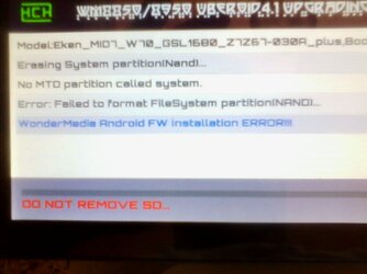

$2013-09-03 17.43.01.jpgHello everyone I have a tabblet n. ° model eken_mid7_w70_gsl1680_z7z67-030a jelly beans I would like to reinstall the 4.1.1
