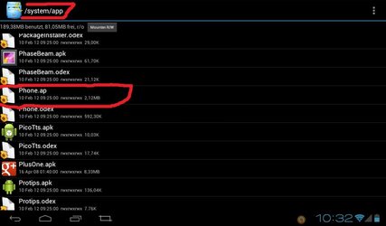

My Instructions:;)
install "root explorer", rename "Phone.apk" in /sytem/app to "Phone.ap" and restart tablet- Cell Standby is deleted under battery-info
