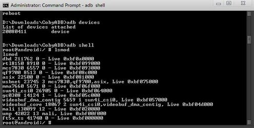

So if you changed the same files as you did for cm9, then touch should work in cm10 as well. so I don't know, why your touch isn't working.
adb shell
lsmod
in cm9
then also in cm10 to see if something is different.
This was the early CM10 oneView attachment 11321
And this is on CM9
wait let me try something. I just missed this In your 9740 thread you named what files needed to be replaced Yes that's what I did!!!! wait I going to do that first.give me a min two I think.
