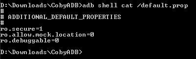

Well ro.secure=1 ??? that must be 0 when it's rooted right?
Ok now I'm a huge step ahead :)
