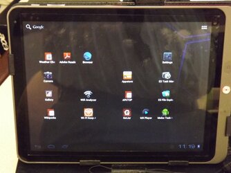

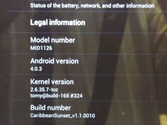

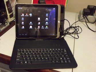

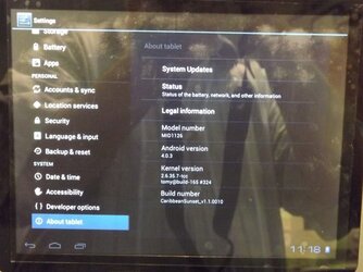

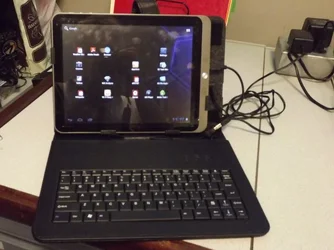

Under ICS 4.0.3 I found that the lock and Del keys of a USB keyboard function properly. Using a USB hub I was able to get both the USB keybaord and USB wireless mouse to work. Images show the MID1126 running ICS 4.0.3 as downloaded from the German Coby site.
