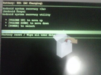

I neeeed helppppp Pls guys. I went into recovery mod then did a restore but changed my mind and just wanted to reboot back to my system. and it got stuck in this recovery crap and only givin me 2 options. reboot or factory wipe. I've done everything,Literally.Power + vol down) reset + vol down) reset + power. Everything i do It comes right back to this menu..... I'm gonna$IMG00758-20120322-0006.jpg cry. Please help.... Thanks
It looks like you have a botched system install - and you are into the factory reset mode.
Best way to recover from this would be with ADB - install it, get it working, connect the tablet (make sure the SD card is the one with CWM and the Beta4 install files).
And type in the magic incantation 'ADB reboot recovery', you will be taken right to CWM.
DON"T forget to wipe the 3 caches (User Data, Data partition, Dalvik cache), and use 'install zip from sd card' to install CM7.
See my guide for ADB here to get it working. Good luck!
Hi there, this is a super easy fix. I had the same issue first when trying to install the CWM files. Follow setups below. Your tablet in a recovery weird mode
Connect your usb power (yes connect it unlike what the firmware instructions say)
hold vol- + power... you will see a weird screen and it will be in some odd recovery menu. ENABLE usb and boot into recovery.
if you have the CWM files on your SD (which you should... way better the default ones) it should load up perfectly, you can now unplug your USB
Restore previous or flash rom from zip... go up up down down until back button is enabled.
Pretty simple... took me about 10mins to figure out.
I'm back to Froyo myself... until this ROM is 100% complete... great work though BTW! This think definately needs an OC kernel.. would love to get 1200 or 1300 out of the CPU if possible... lagging in a few MKVs i got and I HATE HATE HATE reencoding movies :)
post back if your confused about the steps.
I neeeed helppppp Pls guys. I went into recovery mod then did a restore but changed my mind and just wanted to reboot back to my system. and it got stuck in this recovery crap and only givin me 2 options. reboot or factory wipe. I've done everything,Literally.Power + vol down) reset + vol down) reset + power. Everything i do It comes right back to this menu..... I'm gonnaView attachment 6033 cry. Please help.... Thanks
