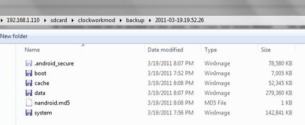

Yes, I have a backup... I have all of the files that J515OP mentioned on the previous under backup, but, the recovery .img isn't listed under the backup, it is all by it's self. Actually is just says 3.0.1.0. Is that the way it should read?
Where (and why) are you looking for the "recovery.img"? I am not sure what you are looking at when you say it just says 3.0.1.0 either.
When CWR creates a backup, it stores the backup on the SD card and should look like this:
Is this what you are talking about?
