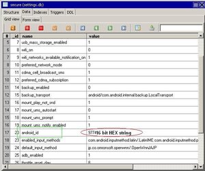

C) For whatever reason, the "android_id" is in located/referenced in two different databases.
One location is - /data/data/com.android.providers.settings/databases/settings.db in the "secure" table. It's a HEX value.
The other is - /data/data/com.google.android.gsf/gservices.db in the "main" table. This is a Decimal representation of the "android_id".
Are they the same values? This site has tools to convert between HEX and DEC. If not, try replacing with your "ugly hack" "android_id" and ensure they are the same value in HEX and DEC. If you need the steps to replace manually, that would be another discussion.
This is why this is a Work In Progress and Not a How To
Investigation of "android_id" in "secure" table in "settings.db" using SQLiteStudio
Note: Still working on why the "android_id" is defined twice however, it would make sense that they should match.
A guess - One is is populated each time the device is factory reset as it may be provided by the partner to allow Gmail to work. Is this the one in HEX starting with 977xxxxxxxxxx?
Once replaced with the one created with the emulator for the "ugly hack" on 2.01 which started with 322xxxx and using it's Decimal value in the other location, "Free" applications are displayed and download.
