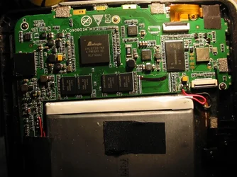

It still seems there may be some utility in persuing this method. Below is a photo of the 8065 system board:
This shows the AML8726-mx. To the right is the Micron chip that is the location of the reset pins for deep brick reset. The 4 ram chips sit near the bottom of the board. Notice the 8060 marking on the board.
Please post any comments ideas you may have.
