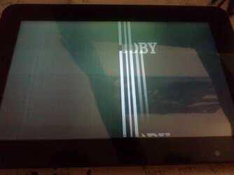

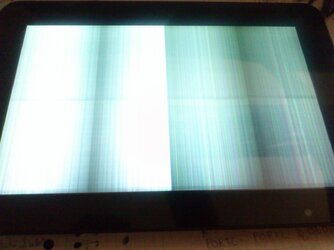

the stock rom is for 9742 and mine is 9042.. I flashed "cwf_coby_9742_4.0.3_1.img" using livesuite and after that I think due to resolution conflict between the 2 models my devices display got screwed. I didn't make a dump file.. Any suggestions...
I am attaching some images about the display issue I am facing with my tablet. Hope someone can rectify it.. $DSC_0064.jpg$DSC_0063.jpg
