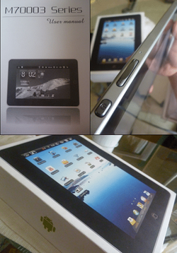

Here are the screenshots of our tablet... its a MID M70003 orphan. Specs on the picture.
No LED power indicator
No Home button, just OFF and Volume buttons on top
Other ports shown in the pictures below
Thanks in advance guys, HAPPY NEW YEAR!

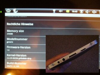

Hi Tipstir,
found your Tips here and think its great Work.
I bought me this MID Pad, no other Markings on it so i took a Photo whi is attached.
It is:
Memory Size 256
Firmware 1.6
Kernerl Version 2.6.29-00236-g4f8dbbb-dirty
Build WMT2.1.2-105
The Connector is 24 Pins
Im wondering if the 256 Firmware with setcpu will increase speed an get the real AppMarket Work !
