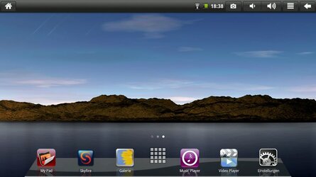

$2011-4-21-18-31-6.jpg$2011-4-21-18-38-4.jpgThat is exactly how it happened. I flashed the pad without noticing, that the bootloader-discovery file was in the root folder as well. Damn me. Fortunately I have another pad of the same brand, that is still untouched. If I knew how to download the bootloader of the second pad and transfer it to the first one, everything would be fine again.
I just noticed, taking screenshots of the unflashed pad, that the resolution is 1024x576 indeed. Hopefully there will be someone with enough knowledge to help.

I took a screenshot too to see which res I'm running and it's 1024x600. So as yours, my pad is made to run with 1024x576 resolution and that explains why we are missing 24 lines of pixels.
After some researchs it seems that we need to flash a ROM made for 1024x576 res and the problem is that all ROMs that I can find are 1024x600.
