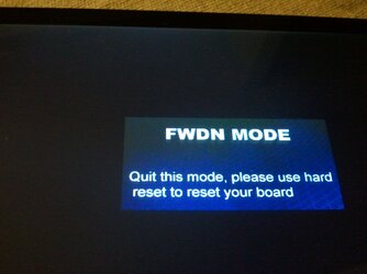

hi everyone!
i have erisin es8135 android 2.3.5 about a week and after an unsuccessful media file transfered via bluetooth from cell phone to tablet at home, tablet gone crazy!!At first couldnt do media scanning and nand damaged error came on.nand card now is empty but it seems ok .Tablet restarts after 20 sec all the time with wifi on and storage com.android.providers.callendar error came on!when i disable wifi it restarts immediatly.if i dont touch wifi,tablet stays on about 20 sec and restarts.I can see all the files on sd card but cant open any media file cause media scanning is on all the time,tablet says.when i do factory reset it stuck on welcome android robot screen and cant open.when i do reset with a stick behind the tablet it starts and stays on about 20 sec and then restarts again as i described above...anyone can help???any missing file??

thanx for the reply!
the problem is on cards scanning when tablet starts.nand is not working right as media scanning runs all the time and finally i can see only sdcard using android explorer and no nand!!!.when i try to unmount nand through storage configuration options ...tablet restarts with wifi on....so i cant touch nand.is this software or hardware problem??

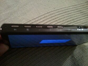

Hi guys again...any ideas please??
The problem restarting tablet after 20 sec kept going on and finally tablet now cant boot at all! it stays on android robot screen and cant open.Reseting through the hole behind the tablet cant open it.The only mode i can access now, is FWDN mode holding home and power buttons but i m not quite familiar with this and how it works.Other combinations with the buttons do nothing! Is there a way i can solve this problem or files i can update to make it open??? . i used this, only for a week and i had another problem when tablet hooks on main unit.Everytime works different...never the same like before.Screen goes crazy showing everything upside down like looking on a mirror!...but keeps working.I ll put a video later when tablet works first.
2 major problems just in a week! great product so far....
pictures with fwdn mode and 5 buttons if anyone can help....thanx!!! $2013-05-26 21.41.37.jpg$2013-05-26 21.57.25.jpg
