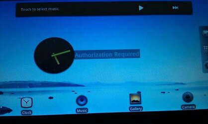

I Have The Dm7033 also and i managed to install a working update file. everything works just fine but the only problem is i have always a message in the middle of the screen saying "Authorization Required" i go to "settings" in "about device" "authorization" and try to register my device but it doesn't accept the machine id... Any ideas how to remove this message???
