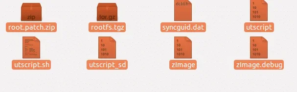

The new link only has the files in the screenshot attached. Am I missing something from the download? I tried to flash with just these files and I got a "No image to update" message and my tablet shutdown (and now it won't boot stable).
Also, I noticed the Zip and Tgz files. Should those be unpacked before flashing?

Sorry forgot to mention the new fwinstaller only requires 6 files maybe four but,it works. i could use the thunderstorm installer but I have been using this method lately and haven't had problems.
I must have done something wrong because the installer didn't work for me, but I combined the new files with the 4.04 from 5/23/12 and replaced files.
Appeared to work and I'm happy with the install.
