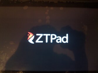

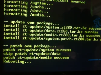

I have Zepad c91 tablet and ihave same problem. after the power down under 30%..it became dead. then i try to re install the upgrade firmware .but can not restart only blank screen with ztpad logo ... see pics of re install upgrade screen. please ..can you help me
I tried dealmaster trick , not working.
tablet battery is drained I connected the AC Power adapter then IMMEDIATELY (after 3 seconds) pushed the power button.
still black screen
