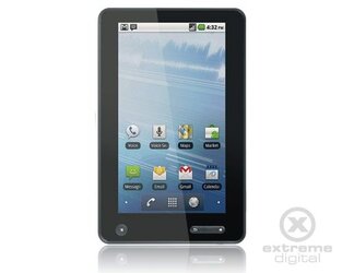

I have a tablet called Concorde Tab 7.1 only sold in Hungary as far as I know. According to the specifications it's pretty similar to the Coby Kyros 7015:
CPU: Telechips TC8902, ARM11, 720MHz
256 Mb of ROM
4 GB flash memory
Same connectors in the same place (HDMI, USB, SD slot..)
Some pictures:

Most the of issues is due to the fact that everything is set off position. If features are enabled then all this graphic issues won't be such an issue. I don't want to confuse anyone here but I've been testing this out Build 12L shows you what I mean I've changed the VMHeap from 24 to 38 and there are no white boxes and the LCD-D is set to 200 again no issues. If you go to the China site for LonPad they make the KYROS 7015/7015A for COBY. Specs clearly shows what you have. 720MHz Telechip. 3D OpenGL Engine. This engine needs to be throttled otherwise all sorts of issues. Patch is good, but I've gone beyond it.
LonPad, COBY, got this one above from the member and there is another one also all 4 look the same. There are differences in the features though. You should backup your ROM prior to any changes you do. COBY and FCC here certain features that other countries might allow where here we don't allow so your specs might be the same but you might have features we don't have. Like the China version of the LonPad has full 3G and a different task menu setup. I've looked into the COBY ROM base and sure enough it has the same features but are not coded into the tablet.
