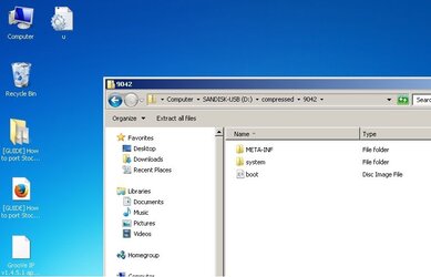

as to how i made it , well i watched somebody else's rom to understand the zip structure ,
now, i uncompressed system.tgz to get the system folder, and boot.img is boot.img.............
and meta-info is the so called "commands", you need to know where boot.img belongs to and how to mount and unmount system in order to flash it.... but if you are trying to compile for the MID9042 you can always use this zip's META-INFO
