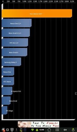

:eek:Again best of 5, 2900, 3100, 3095, and then above..:eek:
CPU stepping via NC Tweaks 300,600,900,1200,1350
Stable>will report back on battery life when I get home from work.;)
Simply unbelievable LS. I knew the Nook had great potential but I never thought it would hit those numbers when this all started. I thought my Nook was running pretty good on CM7 from SD card but hadn't checked my score in a while. A little disappointed to find I am only getting around 1300 at 925MHz. Feels a little better than that in use.

Rebooted, it's been a while, reran and got a 1382 that is a little better. I was sort of hoping to see 1400-1600.
Dang JP, I get 2000 running CM7.1 @ 925.
