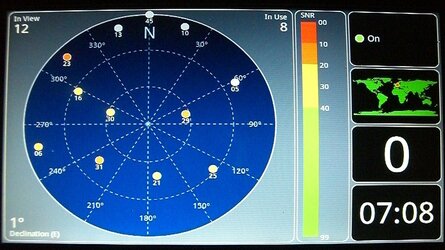

Here's a similar screen from my Witstech A81G tablet, this is how a successful GPS fix looks like:

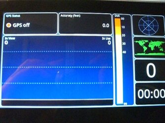

I just put this GPS Test app on a device that definitely does NOT have GPS (this is the Wopad) and it looks like this:
As you can see, there is a RED dot and "GPS off". No surprise ;)
Our Kinpad on the other hand gives us a YELLOW dot, so I thinks it's save to assume that a GPS unit IS on board, it "just" won't find any satellites.
Since I am not the only one having this problem, I can assume that it's NOT just a hardware defect on my device.
So, MAYBE it's just a question of a firmware fix after all?
