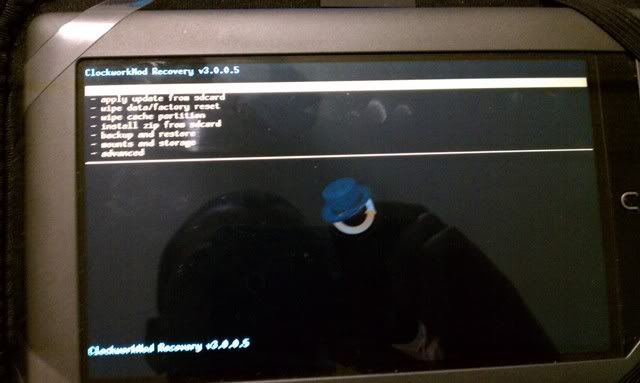

Ok CWR now installed. I need to install busybox, yes I know it come with auto-nooter but remember I'm doing everything manually. Anyway, installed smoothly, booted into recovery with an issue and backed up completed. The only files I'm missing is recovery.img. Here are a few pics:

Close up of home menu in CWR

Every time I try to boot in recovery or install from rom manager my Nook Color reboots and says install fail. I am trying to install the 950 overclock. Is there something else I need to do? I have rom manager with ClockwordMod 3.0.0.5. Thanks for your help.

More info please:
-Did rom manager install properly?
-Do you have busybox installed?
-Did CWR install correctly?
-Is the zip for CWR on root of you sd card?
-Are you able to get into CWR?
-If so, did you perform a backup to your sd card.
Before trying to flash anything in CWR, lets establish you CWR is working properly.
Thanks rico2001. I didn't have it in root. I flashed everything again and now I am at 950 mhz. Thanks for the list of questions, it helped alot.
