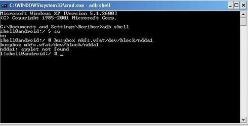

what application needed to input that codes? via computer using usb cord? or i will do that thru my tablet?
acidburn23
Dec 3, 2012
135

you have to have a space you put it all as one code.
busybox mkfs.vfat space /dev/block/ndda1
Code:
busybox mkfs.vfat /dev/block/ndda1
vampirefo.
Developer
Nov 8, 2011
3,836
1,394
why are you typing commands like that?
please stop, i never told you to type a command like that.
adb shell
su
why is it so hard for you?
adb shell press enter
su press enter
busybox mkfs.vfat /dev/block/ndda1 press enter
each and every command has it's own line stop putting the commands together.
