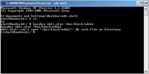

adb shell press enter
su press enter
busybox mkfs.vfat /dev/block/ndda1 press enter

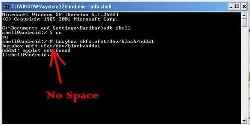

and i try another output
su press enter
busybox mkfs.vfat/dev/block/ndda1 press enter

Ok that's it, nothing can be done, your /dev/block/ndda1 is completely gone. There is no tool that I know of that can create partitions on the Coby telechips tablets.
Had the partition just been damaged the above command would have fixed it, but seeing the partition is completely gone there is no command to fix that.

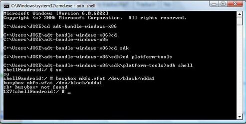

In the the first post it explains exactly how to install it.
you can also get busybox from market,
first run this command, postout.
adb shell
su
chmod 755 /system/bin/busybox
busybox tar --Usage
