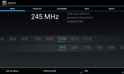

Can you overclock kernel a little..like 800 mhz to be 1 ghz and 1ghz like 1.15. .it can be always downgraded with set cpy or similar program
check the overclock dir
1036800,
1075200
1113600
new freqs (it runs as same vcore as 998)

There is just one boot.img there and no luck..it booted first time and fail in 5 seconds..after that it would not boot at all..maybe give that boot with lower..i would not add vcore until google it how this cpy handles it...but i saw on other forum that they runing on 1150 on desire
the default value is 998mhz, its fine for me at 1036
What version did you upload..that of 1036 or some other..if no can you upload that of 1036
i mean by default it runs at 998mhz at top, but u change it e.g. with setcpu, so by default it boots at 998mhz, not over 998mhz
Is that version you upload?
There are 5 different fq from 245 to 998...did you change all or just one..
check the pix
p.s.: check the latest build, i merged the oc'ed kernel into it, and plz feedback

Yes but you should make kernel where top is 1.03 or little higher..i cant even go to setcpu to lower fq to 1.03 because it crashes before it.
