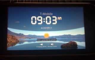

7: turned on tablet and woooooot IDEOS splash screen comes up, then comes up again, then an animated splash screen comes up ..... loads into desktop with the calibration screen ( will also show you the system upgrade is completed)

S7-105 Telstra S7V100R001C13B021 now IDEOS S7, BB 504030, Kernel 2.6.32.9-ideos Build S7V100R001C98B021.
