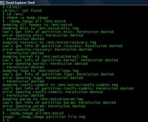

I'm looking for someone who has a rooted COBY MID7024 with an otherwise stock ROM that can run a program I have modified. It will dump the contents of the NAND flash to the external sdcard. Once you have the image files for the nand partitions I would ask that you either post them or send them to me. I am wondering if I can create a recovery ROM based on the images that we get. My next project is trying to get the original uboot off my tablet so we can help those who have overwritten theirs.

I tried to do this but when I typed "chmod +x dump_image" and pressed enter I got the message:chmod: dump_image: operation not permitted
The tablet is rooted. When I click on the folder "data" on droid explorer nothing happens, it doesnt show "local". But when I use root explorer I can copy the dump_image to data/local (and that's how I did)
Try to put to dump_image somewhere else then like /etc/ and see if you can use chmod there. Then continue with the instructions.
SU then try again the instruction of tileg it will work now.
You could also use root explorer to change the permissions on dump_image.
Select all the executable check boxes.

I did that but I got a lot of "permission denied errors", you also dont explain what I should do next, what file should I send you? Is it a file in the sd card?
