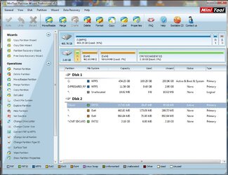

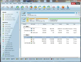

OK new question. How do I increase disk size. I am including a photo of my partition. It contains two 4th's?
Thanks.

Jimmy, it sounds like you got yourself straightend out. Yes, you unzip the image file so you can burn it to the SD card but you do not unzip the other files.
Regarding your repartitioning, just let the size agnostic script work its magic. What you end up with is an SD card with 4 main partitions 1) 115MB Boot (this is what is seen when you put the disk in after booting to eMMC), 2) 460MB for system, 3) 975MB for data (your "internal memory") and 4) the ramiander of the space for your "SD card" when booted into the SD ROM.
To have more usable space when inserting the SD card after an eMMC boot up, shrink the "SD card" partition and enlarge the Boot partition (both of these are the FAT32 partitions in your screen shot).

1. emmc is Nook internal memory. To boot to it you just remove the bootable SD card while the nook is turned off then power on and boot as normal. Your Nook will boot into what ever configuration you have it setup for, stock, rooted or custom ROM.
2. Not sure about that. Maybe your partitioning tool needs the disk spcae to be sequentially allocated so that even though you have free space it can't add that to the boot partition if there is something else backing up to that partition. That is just a guess. You might want to check out the help section of your partitioning program.
