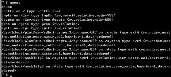

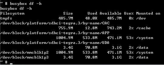

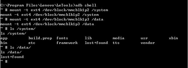

I think my data partition has some problem too
as you can see, i only have the lost+found folder.
Here is the rest of the code:
I don't understand your output, is this done from cw recovery?
your output shows you are mounted to system and data twice which is not possible from cw recovery.
Ohh my bad, but when i boot into recovery, my computer can't read my tablet for some reason
How to use the adb shell in cm recovery? My computer doesn't seem to read it at all, so i cant type the code.
Never mind i got it!!!:D Sorry im such a noob
you are showing that you are mounted on system and data twice, is this jb cw recovery? I have never seen this, basically this is bind.
