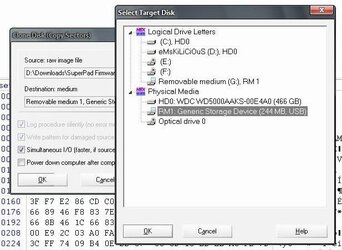

!Make Boot sector to SD Card! *Caution, This is the only place you can screw up and your sd card should result in a 700mb storage device, if not you failed.
~Run WinHex.exe
1. on the toolbar click... tools, disk tools, clone disk
4. Checklist...source: raw image should be chosen as your sector.001 file, destination medium is going to be your sd card, start sector (destination) Fill in 0 (zero) and click ok. if you recieve any temp. file locator errors, ignore them unless its concerning your preporation setup or this process wont work.

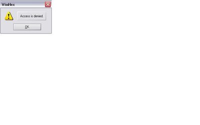

I followed everything to the tee, but I'm getting the following error "cannot create "
Hello,
i did the steps as well, WinHex writes to SD card without warnings. at the end, the log file pops up with successful entries but another pop up window comes up saying "access denied" The SD becomes unaccessible and format is requested. After formating it shows normal capacity, not 700MB. i tried this with 4 and 2GB cards.
i have been searching the forum and the internet for two days, can you help please?
Thanks, Yousif

Thanks! nothing confusing at all. i followed all the steps without a problem, in particular up to this step:
then Winhwx finishes writing and i get this log file:
21/04/2011, 22:14:55.8
C:\Documents and Settings\winPad\flytouch2-ROM-recover-card\aben.start sector.001 --> Drive F:
Beginning of file --> Sector 0
16,065 Sectors
21/04/2011, 22:14:58.1
16,065 sector(s) successfully copied.
when i close the log file i find a small window saying access denied:
when i click OK, it says successfuly copied. i ake the card out and reinsert it, i try to copy android folder, it asks for formating and i click yes, quick format. Then it copies the android folder. that is all. i have tried more than ten times with two cards. i am using a laptop with WIN XP SP3
Yousif
Make sure you are choosing the physical drive not the logical in winhex, and also run winhex as administrator.
Thanks to everyone here. i used my brother's laptop with win7 and took less than 5 minutes and one attempt to do the job! i guess there is some security setting in my work laptop that did not like the process.
