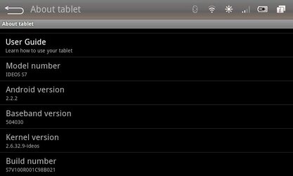

$2011-04-21-10-18-32-014.jpgHi Guys
Thanks for the links
Have Downloaded and installed as per install instructions and can report that all is working perfect (So Fast ;) ) on my S7 103. I can also confirm that you must install twice as instructed or it does hang at boot.
