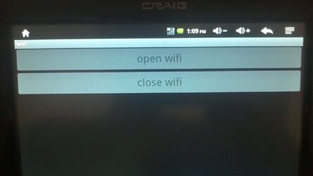

Theres a stock wifi app that you can open and close the wifi. Has anyone tried that?
Hi m3red,
I'm not able to select open or close using the wifi app it's all greyed out.
I have taken a picture of the Wireless & Network settings as well as the wifi app.
I think that Regena have a valid point on the following post. http://www.androidtablets.net/forum...-market-clean-rom-img-file-10.html#post166810
