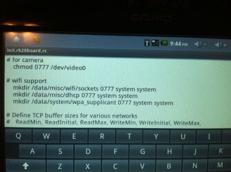

Found some more wifi settings in the init.rk28board.rc file in the main folder. Im using Es file Explorer and it will let you open the hidden files and folders. Goto settings click on Home directory and change it to / . then click File settings then put a check by show hidden files.
Download the file and put it onto a SD card then into your tablet and install it using APKinstaller
Download ES File Explorer Here
Time to wipe my cmp738b and try a few things.

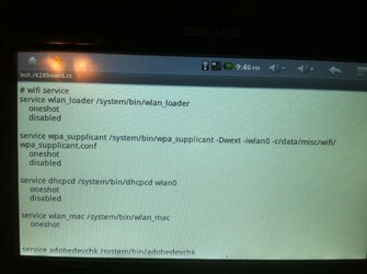

Found three section with Wifi. Two of them are exactly the same as the Screenshot
# give system access to wpa_supplicant.conf for backup and restore
mkdir /data/misc/wifi 0777 system system
chmod 0777 /data/misc/wifi
chmod 0660 /data/misc/wifi/wpa_supplicant.conf
mkdir /data/local 0771 shell shell
mkdir /data/local/tmp 0771 shell shell
mkdir /data/data 0771 system system
mkdir /data/app-private 0771 system system
mkdir /data/app 0771 system system
mkdir /data/property 0700 root root
# wifi support
mkdir /data/misc/wifi/sockets 0777 system system
mkdir /data/misc/dhcp 0777 system system
mkdir /data/system/wpa_supplicant 0777 system system
# wifi service
service wlan_loader /system/bin/wlan_loader
oneshot
disabled
service wpa_supplicant /system/bin/wpa_supplicant -Dwext -iwlan0 -c/data/misc/wifi/wpa_supplicant.conf
oneshot
disabled
service dhcpcd /system/bin/dhcpcd wlan0
oneshot
disabled
service wlan_mac /system/bin/wlan_mac
oneshot
