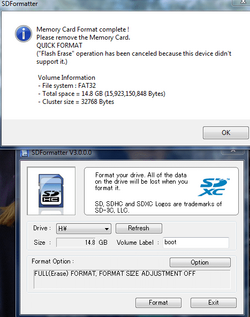

So something weird is going on. I just realized I had another card I could play with, this one a 16GB CL2 SanDisk from an older Blackberry (have backed up all info off the card I cared to keep). I went ahead and tried to use SD Formatter v3 to do a full erase format and it had the same problem. Here is what I have in SD Formatter and what it says after it runs:
I have uninstalled and reinstalled SD Formatter more than once to ensure it was a good install, so I am at a loss now.... I am running Win 7 Home Premium x64 in case that matters. I have ran SD Formatter as Admin (right-click run as admin) just to be sure that wasn't the issue and it doesn't help....
Since it appears the Full (Overwrite) option works (but takes a long time), do you think that is good enough or should that work as well as a Full (Erase) option?
Any other SDHC formatting tools I can try?
