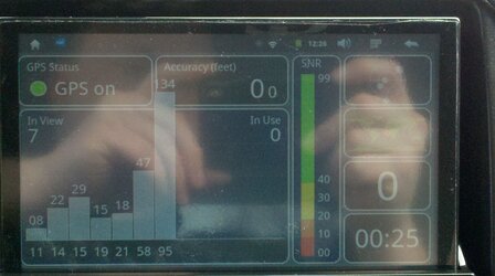

Hello all, I have been reading this thread for the last few days while moding and working with my ES777A, and I am having problems with my GPS, when I first installed the head unit about 2 weeks ago the GPS worked great, worked with google maps and iGo, but now I cannot get a gps fix. I installed GPS Status and GPS Test and used both to reset and update the A-GPS with no luck, both apps report 6-10 sat in view but will not lock on any. I am going on a trip in a few days and need this fixed quick. Thanks for your help.
Update:
I did a reset (reboot with power & back button and wiped all data) and it worked for about 5 min then lost fix and will not get new fix. Here is a pic of what GPS Test shows. I am at a loss of what to do to fix this. BTW I do have root access.
Hi Flytyme69,
One thought occours, another forum member (I think it was TDI_VOTEX) had gps problems & it turned out to a fault with the cable broken but inside not visable from the outside if I remember right. Do you have access to another gps pick up unit to try replacing it ?
Another thought is to ask you if you have placed the gps pic up unit outside your car ? as some have put them inside the dasboard, but they are designed to go outside.
Update:
..., another forum member (I think it was TDI_VOTEX) had gps problems & it turned out to a fault with the cable broken but inside not visable from the outside if I remember right...
Yes it was me, but the fault in my cable was completely shorting the cable and I had no signal at all, not even a sat.
This looks more like a software problem.
Edit: One tough I just had, does the S/N ratio fluctuate a bit or does it look like it is frozen? Some Apps like "Simple NMEA Monitor" enable us to see the NMEA sentence coming from the GPS chip. With it you can diagnose where the message get lost.
Hi Flytyme69,
Have you tried disabling any non essential apps from starting up & then reboot, I' was thinking about tdi_votex had posted & was wondering if another app was interfereing with the gps . I'm no android expert but I have had similar issues on windows based kit.

Hey guys, thanks for the info, I am going to try them out and post back, I have been away on a family medical issue, thanks for ya'll feedback.
Well I couldn't get that to work, downloaded Simple NMea app and it doesn't show anything. Other than gps status, IGO and maps no other app installed... could the root be messing it up, how could a do a full restore, cause when i did the reset it still had root and super user installed.
